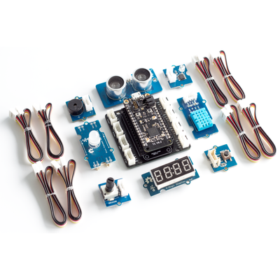

Grove Starter Kit
The Grove starter kit is designed to make your first exploration into the world of sensing and actuating a breeze. The kit comes with seven different components that work out-of-the-box with Particle Gen 3 hardware and let you focus on learning the basics. Working with Starter Kit requires no soldering and minimal wiring. Simply connect the kit’s Grove Shield (the new co-developed FeatherWing adapter from Particle and SeeedStudio) to your Particle Gen 3 board and use the included cables to connect the adapter and the sensors and actuators that you want to use. It’s a plug-and-play experience.
Kit Contents
  • 1x Grove Shield for Particle Gen 3 devices
  • 1x Button
  • 1x Rotary Angle Sensor
  • 1x Ultrasonic Ranger
  • 1x Temp&Humi Sensor
  • 1x Light Sensor v1.2
  • 1x Chainable RGB LED
  • 1x Buzzer
  • 1x 4-Digit Display
Grove shield
The main shield consists of a connector to plug in any of the Particle Argon or Boron dev kit and a set of 8 grove ports for plugging in various grove accessories. The ports consist of:
  • 3 Digital ports
  • 2 Analog ports
  • 2 I2C ports
  • 1 UART port
The pins on the Grove connector are as follows:
Pin Color Digital Analog I2C UART
1 Yellow Primary I/O Primary Analog In I2C Clock Serial RX
2 White Secondary I/O Secondary Analog In I2C Data Serial TX
3 Red Power Power Power Power
4 Black GND GND GND GND
