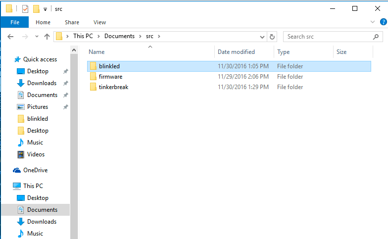

  • For this example I created a new directory in my src directory, as described above.
cd src
mkdir blinkled
  • And I created the file blinkled.cpp.

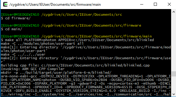

cd firmware/modules
make all PLATFORM=photon APPDIR=../../blinkled
  • This builds everything, including Device OS firmware. You will probably want to do this once, but for subsequent builds, you can save a lot of time by using the command:
cd firmware/main
Here's what a build window might look like in the Cygwin Terminal:
Windows build
