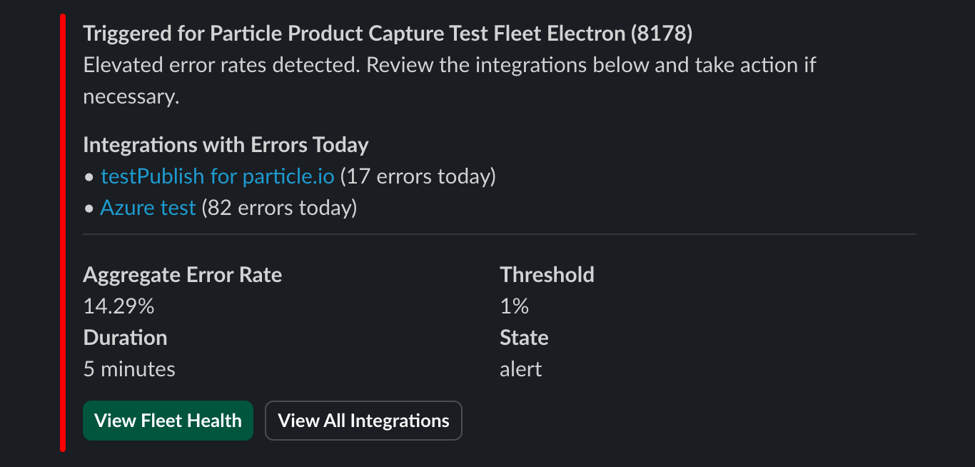

Integration monitor
Monitors Particle integrations for elevated error rates and alert when the error rate exceeds a threshold and sends a notification.
One available notification is Slack:

Slack
This is the easiest and most straightforward way to get notifications. All you need to do is grab a webhook URL from Slack and install it into a new Particle Slack integration.
  1. Create a new Particle Integration at the organization level
  2. Select Slack
  3. Select the same products you entered into the configuration json
  4. Set event name to triggerSlack, or a custom value that matches your configuration json
  5. Enter your webhook url
  6. Set the JSON template to {{{PARTICLE_EVENT_VALUE}}}
