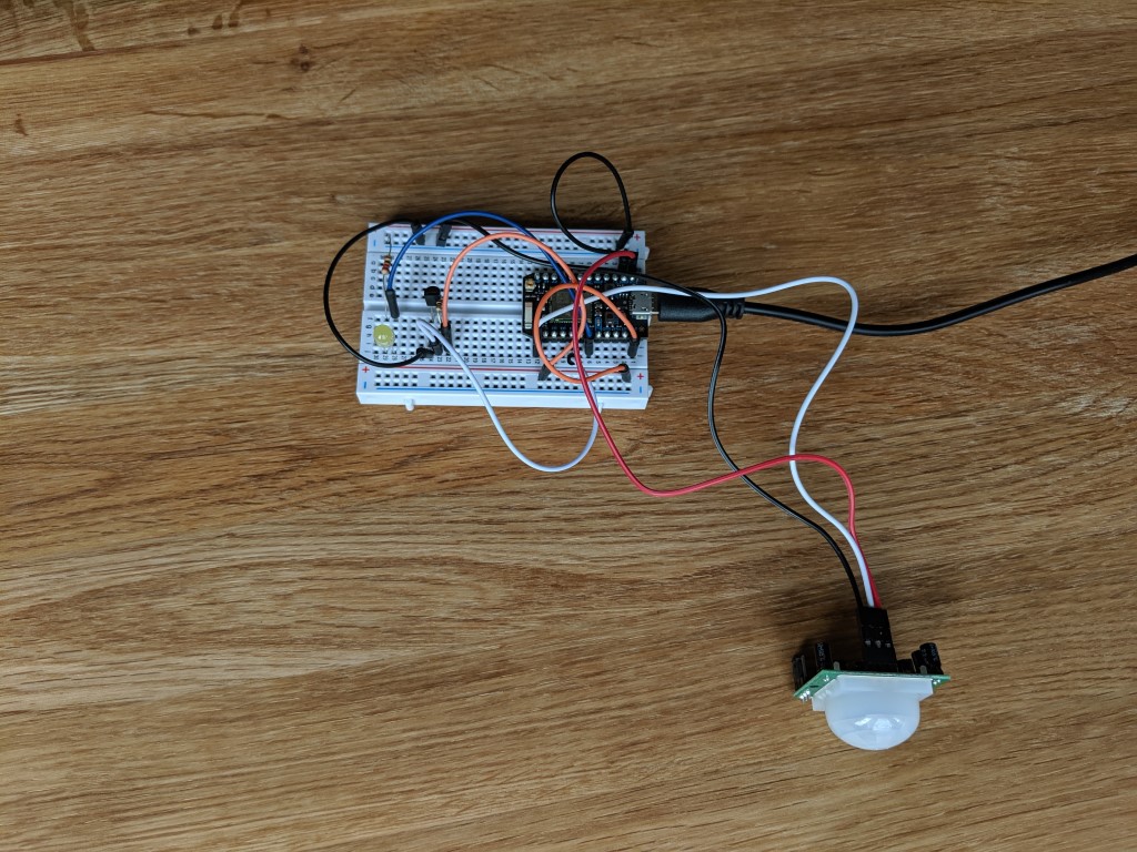

In this setup, we use the Particle Maker Kit with a Photon device to connect an IR motion sensor and a temperature sensor. An LED is also included to provide a direct visual indication of motion detection on the device.
The assembled device is shown in the image above. A detailed guide on how to connect the sensors can be found here: https://docs.particle.io/archives/maker-kit/.

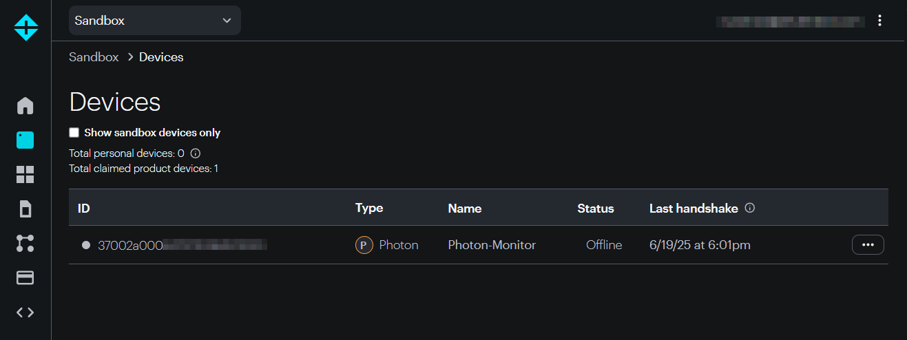

Now you can connect your device to the Particle IoT platform. This can be done easily using the Particle mobile app. A full step-by-step description is available here: Photon setup.
You should now see your new device listed in the Particle Console under My devices: https://console.particle.io/devices.

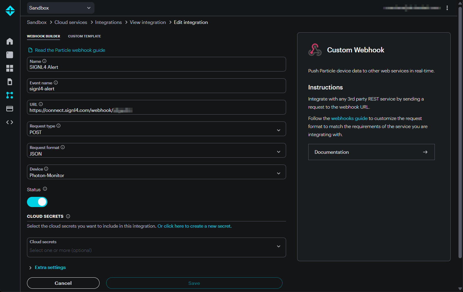

In the Particle Console under Cloud services -> Integrations (https://console.particle.io/integrations), you can now create a new webhook to send alerts directly to SIGNL4.
Create a new webhook and enter the SIGNL4 webhook URL.
The {team-secret} is your SIGNL4 team or integration secret.

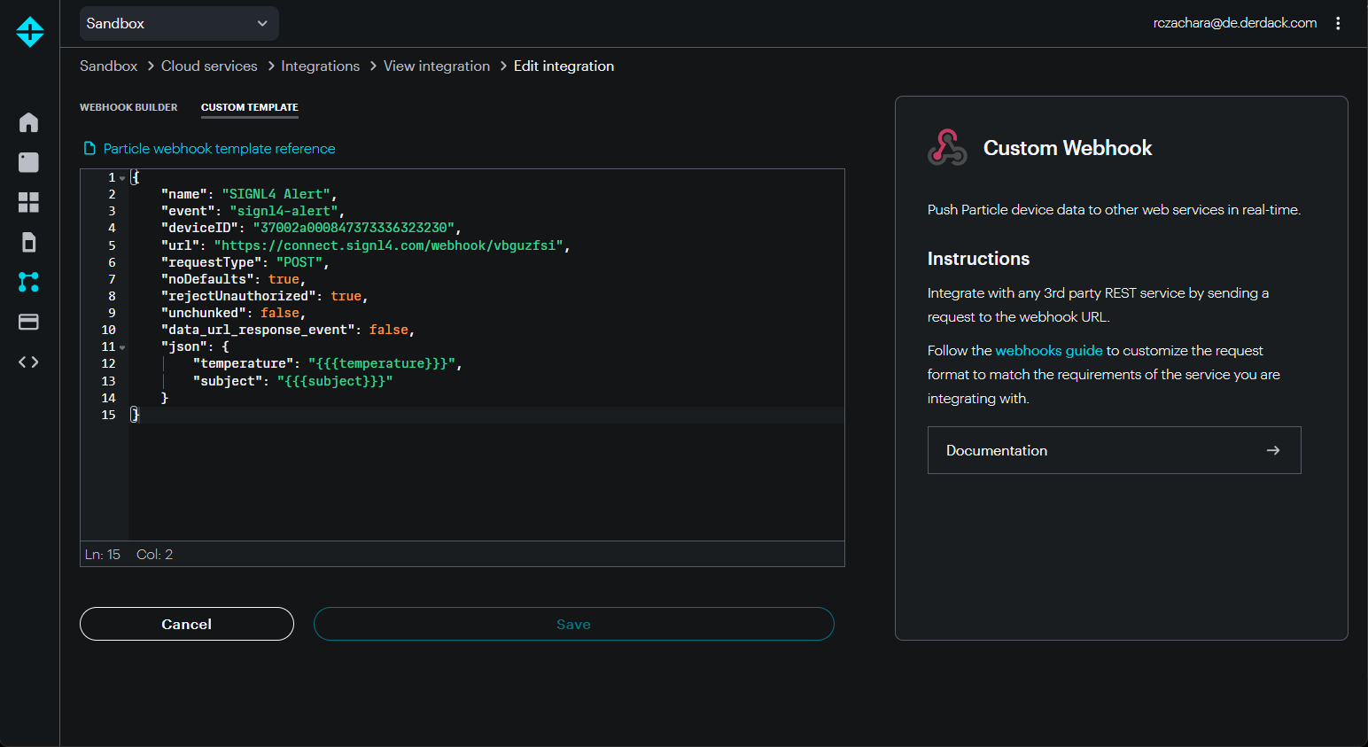

In the Custom Template section, you can insert the JSON data template that will be sent to SIGNL4.
"event": "photon-motion",
"deviceID": "37002a000xxxxx",
"url": "https://connect.signl4.com/webhook/{team-secret}",
"requestType": "POST",
"noDefaults": true,
"rejectUnauthorized": true,
"json": {
"subject": "{{{subject}}}",
"temperature": "{{{temperature}}}"

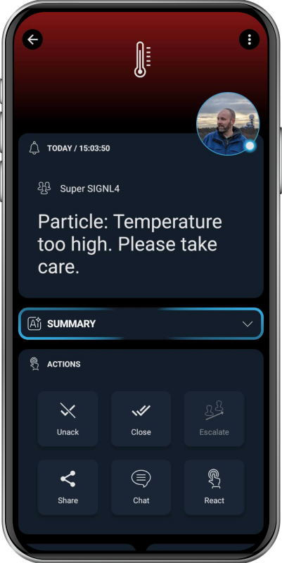

The alert in SIGNL4 might look like this.
