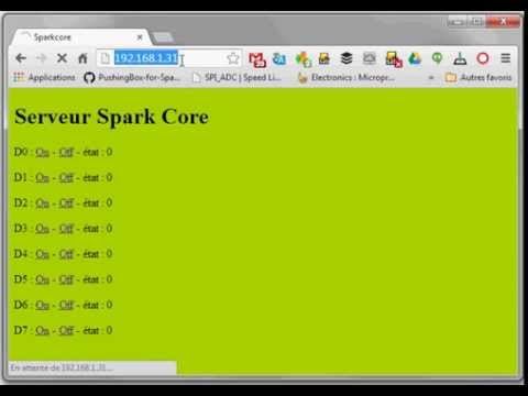

This project implement a Http server on Sparkcore itself. Once compiled into the Web IDE, the server will be available at http://IP-SPARKCORE (port 80 by default).

HTTP server (REST & JSON) on Spark core
alt text (image removed)
EN : Local HTTP server (REST & JSON) for Sparkcore

Projet "spark-Web-Tinker.ino"
  • RESTFull URL : http://IP-Sparkcore/D0/on|off
  • Digital JSON URL : http://IP-Sparkcore/json/dig/
  • Return : {"TS":20140802091229,"D0":0,"D1":0,"D2":0,"D3":0,"D4":0,"D5":0,"D6":0,"D7":1}
  • Analog JSON URL : http://IP-Sparkcore/json/ana/
  • Return : {"TS":20140802091252,"A0":2127,"A1":2117,"A2":2097,"A3":2098,"A4":2107,"A5":2114,"A6":2083,"A7":2085}
