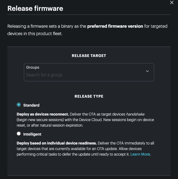

There are two kinds of product firmware releases:
  • Standard updates are only applied when the device handshakes with the cloud. The most common scenario where this occurs is after a reboot or reconnecting after sleep or powerdown.
  • Intelligent updates allow immediate updates for online devices. The device has additional control over when this will occur.
You can choose which kind of release you want when releasing a firmware version in the console:

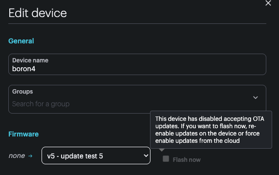

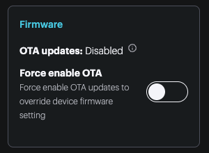

When viewing the device in the console, you can see if the device has disabled updates, and optionally force updating even if disabled.
When locking a device to a specific product firmware version, you can also see if the device has disabled updates.

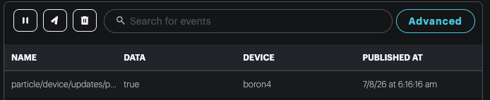

If you release a firmware version to devices using standard update, the update will not be applied until the device resets or handshakes with the cloud. You can see this is occurring from the event stream:
