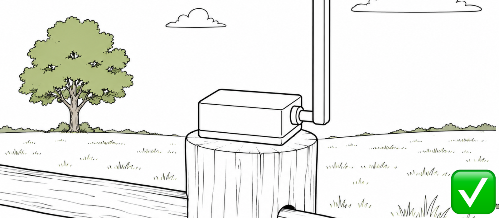

Clear view of sky required
For all practical purposes, this requires the antenna being outside, and not under tree cover or obstructed by nearby tall buildings.
Clear view of sky

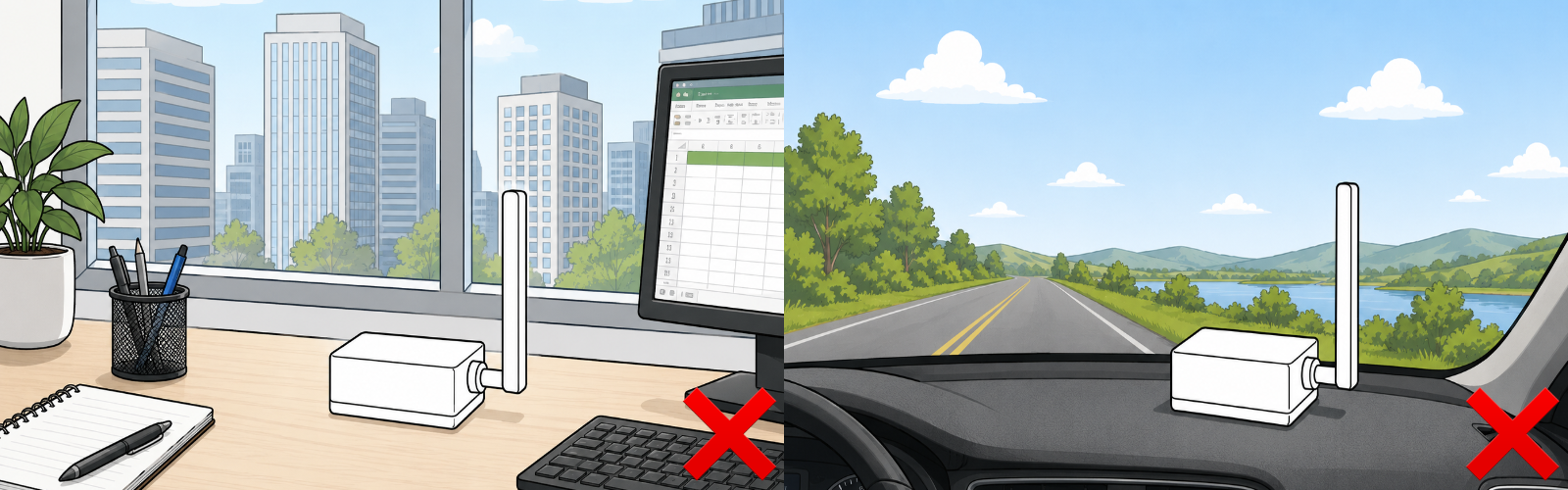

You will not be able to connect with the antenna inside a building, inside a vehicle, or inside an enclosure such as a trailer, shipping container, equipment cabinet, etc..
In general, even putting the antenna in a window will not be sufficient to connect to NTN.
Bad locations
