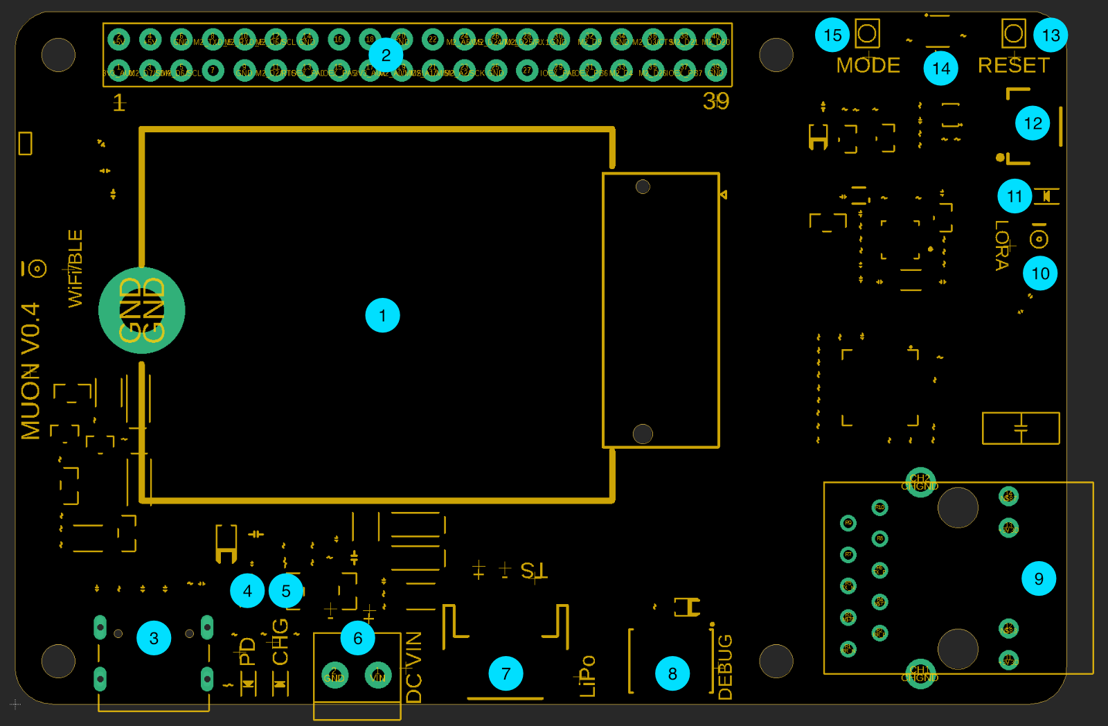

Features
| Label | Feature |
| 1 | M-SoM |
| 2 | Expansion connector |
| 3 | USB-C |
| 4 | USB Power LED ("PD") |
| 5 | Charge LED ("CHG") |
| 6 | VIN (6-12 VDC) |
| 7 | LiPo battery connector (3-pin) |
| 8 | SWD/JTAG debugging connector |
| 9 | Ethernet RJ-45 connector |
| 10 | LoRaWAN antenna |
| 11 | LoRaWAN status LED |
| 12 | QWIIC (3.3V I2C) connector |
| 13 | RESET button |
| 14 | RGB status LED |
| 15 | MODE button |
