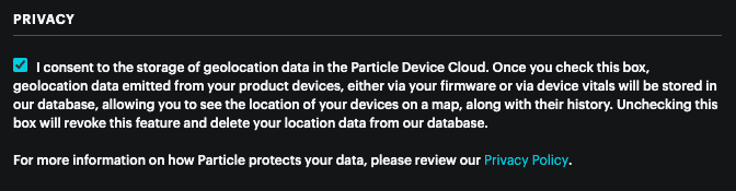

Enabling location services
Geolocation services are only available to devices in a product. Additionally, you must enable location services in the Settings (gear) icon for the product.
Location
