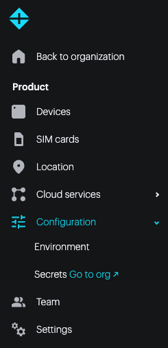

Product - Console
You will often configure your environment variables per-product. Once you have opened your organization or sandbox product, go to Configuration then Environment in the left navigation bar.
These environment variables are sent to every device in this product.

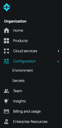

Organization - Console
If you have access to an organization (basic, plus, or enterprise), you can set environment variables at the organization level in the Organization - Configuration - Environment section.
These environment variables are sent to every device in every product in the organization.

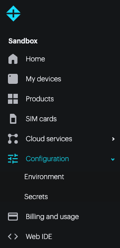

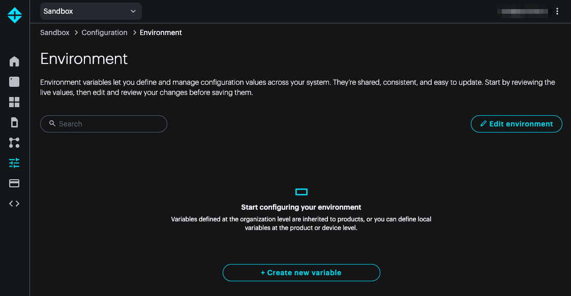

Sandbox - Console
For the free developer sandbox, you can set environment variables in Sandbox - Configuration - Environment section.
These environment variables are sent to every device in every product owned by this developer account.

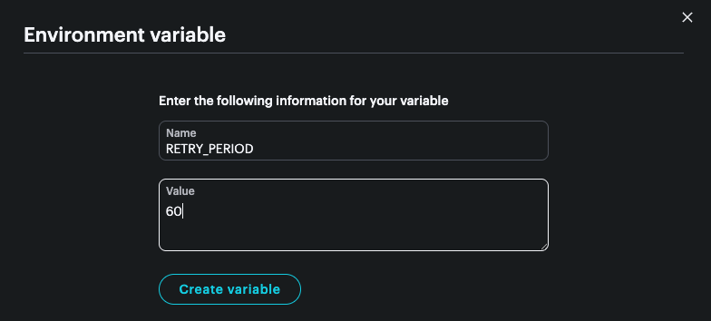

Creating an environment variable
When you create your first environment variable in a scope, you will see a screen similar to this:
To create an environment variable, fill in this screen:
  • Variable names are uppercase letters, underscores and numbers only, and cannot start with a number.
  • Variable names beginning with PARTICLE_ are reserved for Particle use.
  • Maximum variable name length: 128 characters.
  • Maximum variable value length: Not limited per variable.
  • The total size of all name - value pairs to be delivered to a device cannot exceed 16 Kbytes.
  • Maximum number of variables in a scope: 100.
For example, you can have 100 organization variables, and also 100 product variables, as long as the combined size does not exceed 16 Kbytes.

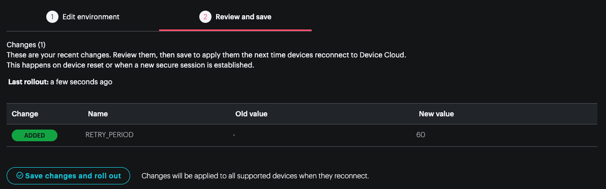

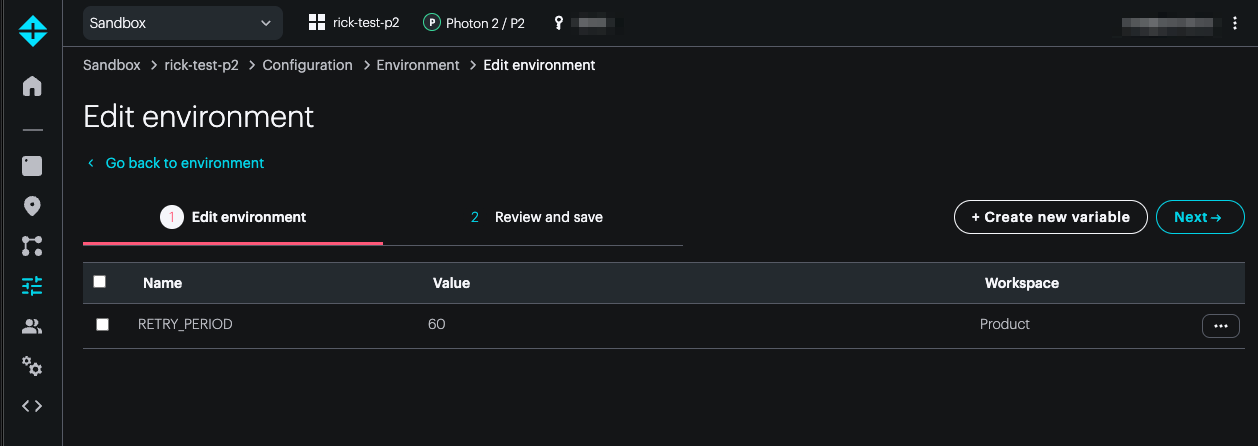

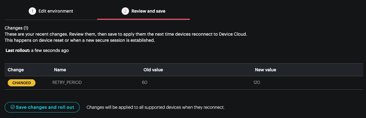

Once you've created a variable, you'll see a list of variables that you have created within this scope.
Creating a new variable does not immediately take effect. Once you have made all of the changes you intend to at this scope, click the Next button to roll out the changes.
Device-level environment variables that are added, removed, or changed are delivered immediately to online devices that have not disabled updates. These are delivered via an OTA update, and the device will have the new values available when the device reboots. Firmware running on the device will never see the value change while running.
For devices that are offline, changes are delivered when the device connects to the cloud.
When a device connects to the cloud a hash of the current environment is sent to the cloud and a new version is only sent if the device does not have the current environment snapshot for the device.

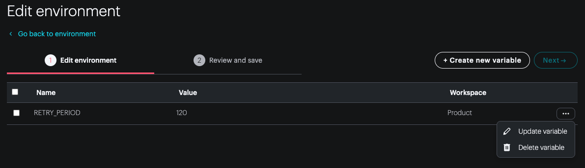

Editing an environment variable
When editing the environment, you can update or delete individual variables.
Don't forget to rollout the changes to devices after updating.
