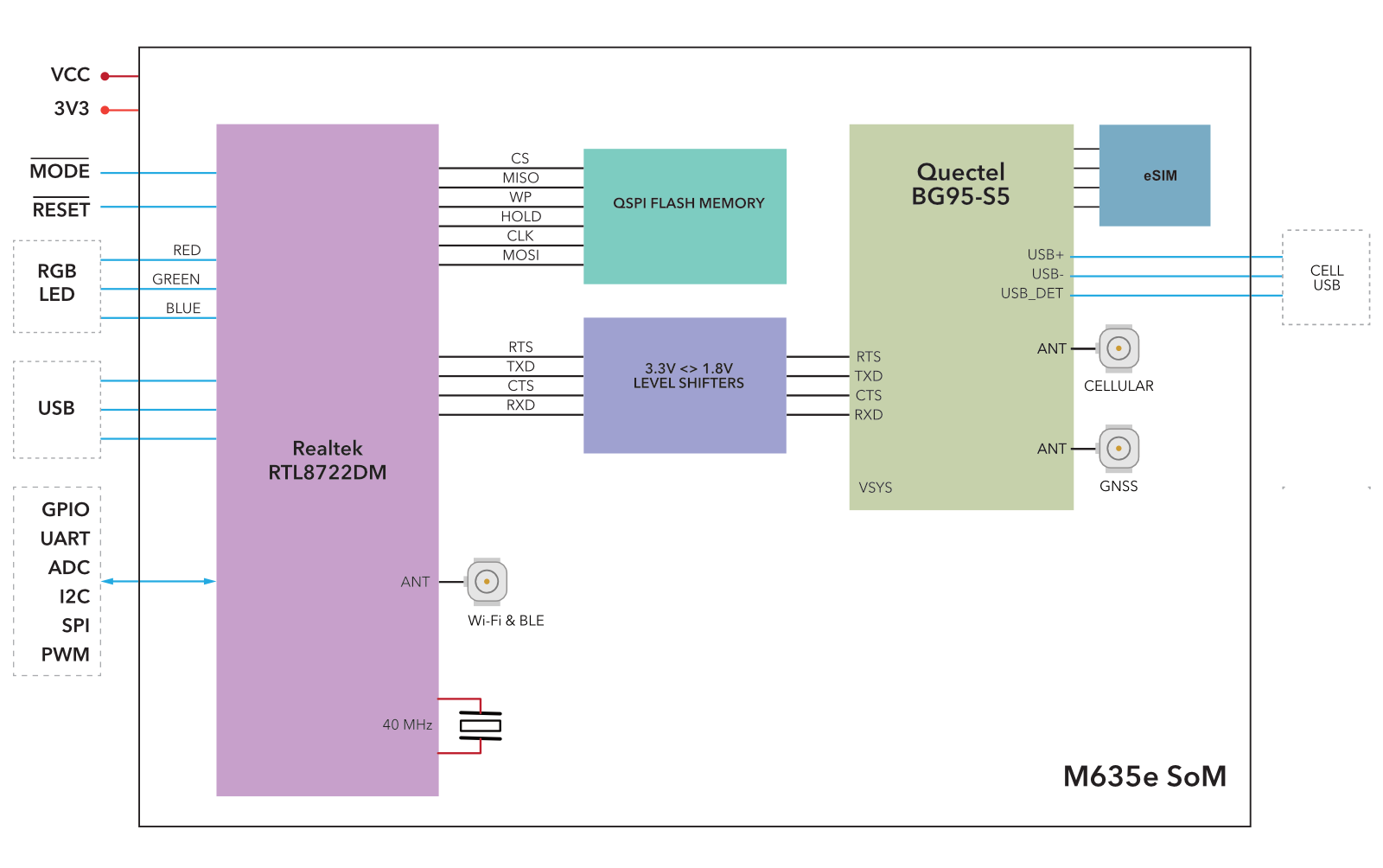

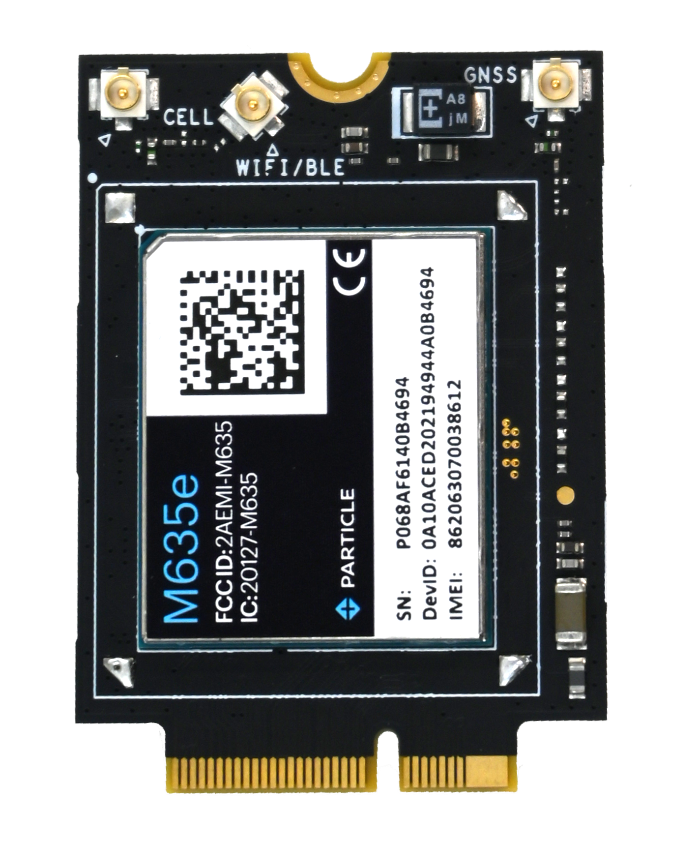

The Particle M-SoM contains the following functional units:
- M.2 SoM form-factor, like the B-Series SoM
- Can use cellular or Wi-Fi (2.4 GHz or 5 GHz) for the cloud connection
- Realtek RTL8722DM MCU (BLE and Wi-Fi)
- Cellular modem
- M404: Quectel BG95-M5 LTE Cat M1 (NorAm)
- M524: Quectel EG91-EX LTE Cat 1 with 2G/3G fallback (EMEAA)
- M635e: Quectel BG95-S5 LTE Cat M1/2G (Global with NTN satellite)
MCU
The Realtek RTL8722DM is in the same family as the P2 and Photon 2 modules (RTL8721DM), but has additional GPIO.
- 802.11a/b/g/n Wi-Fi, 2.4 GHz and 5 GHz
- U.FL connector for external antenna
- BLE 5 using same antenna as Wi-Fi
- ARM Cortex M33 CPU, 200 MHz
- 2048 KB (2 MB) user application maximum size
- 3072 KB (3 MB) of RAM available to user applications
- 2 MB flash file system for user data storage
- FCC (United States), ISED (Canada), and CE (European Union) certified

The M-SoM includes three U.FL connectors for external antennas:
- Cellular (including NTN)
- Wi-Fi (2.4 GHz and 5 GHz) and BLE
- GNSS (GPS)
